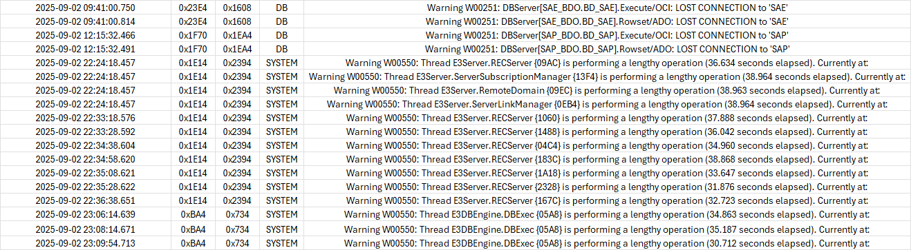

Bom dia possuo um servidor com windows 2019 server que roda o Elipse E3 4.6 o qual ao longo do periodo de funcionando o mesmo apresenta licença indisponível no E3ADMIN. A cada abertura de viewer o mesmo consome uma licença e libera em seguida quando o viewer é fechado.O que acontece é que quando a máquina cliente abre e encerra um viewer o servidor no E3ADMIN não identifica essa ação gerando travamento de licença indisponibilizando assim acesso o viewer com a mensagem de “não há licença disponível de viewer”.Segue abaixo o log do campo “warnning”
2025-09-02 09:41:00.750 0x23E4 0x1608 DB Warning W00251: DBServer[SAE_BDO.BD_SAE].Execute/OCI: LOST CONNECTION to ‘SAE’
2025-09-02 09:41:00.814 0x23E4 0x1608 DB Warning W00251: DBServer[SAE_BDO.BD_SAE].Rowset/ADO: LOST CONNECTION to ‘SAE’
2025-09-02 12:15:32.466 0x1F70 0x1EA4 DB Warning W00251: DBServer[SAP_BDO.BD_SAP].Execute/OCI: LOST CONNECTION to ‘SAP’
2025-09-02 12:15:32.491 0x1F70 0x1EA4 DB Warning W00251: DBServer[SAP_BDO.BD_SAP].Rowset/ADO: LOST CONNECTION to ‘SAP’
2025-09-02 22:24:18.457 0x1E14 0x2394 SYSTEM Warning W00550: Thread E3Server.RECServer {09AC} is performing a lengthy operation (36.634 seconds elapsed). Currently at:
2025-09-02 22:24:18.457 0x1E14 0x2394 SYSTEM Warning W00550: Thread E3Server.ServerSubscriptionManager {13F4} is performing a lengthy operation (38.964 seconds elapsed). Currently at:
2025-09-02 22:24:18.457 0x1E14 0x2394 SYSTEM Warning W00550: Thread E3Server.RemoteDomain {09EC} is performing a lengthy operation (38.963 seconds elapsed). Currently at:
2025-09-02 22:24:18.457 0x1E14 0x2394 SYSTEM Warning W00550: Thread E3Server.ServerLinkManager {0EB4} is performing a lengthy operation (38.964 seconds elapsed). Currently at:
2025-09-02 22:33:18.576 0x1E14 0x2394 SYSTEM Warning W00550: Thread E3Server.RECServer {1060} is performing a lengthy operation (37.888 seconds elapsed). Currently at:
2025-09-02 22:33:28.592 0x1E14 0x2394 SYSTEM Warning W00550: Thread E3Server.RECServer {1488} is performing a lengthy operation (36.042 seconds elapsed). Currently at:
2025-09-02 22:34:38.604 0x1E14 0x2394 SYSTEM Warning W00550: Thread E3Server.RECServer {04C4} is performing a lengthy operation (34.960 seconds elapsed). Currently at:
2025-09-02 22:34:58.620 0x1E14 0x2394 SYSTEM Warning W00550: Thread E3Server.RECServer {183C} is performing a lengthy operation (38.868 seconds elapsed). Currently at:
2025-09-02 22:35:08.621 0x1E14 0x2394 SYSTEM Warning W00550: Thread E3Server.RECServer {1A18} is performing a lengthy operation (33.647 seconds elapsed). Currently at:
2025-09-02 22:35:28.622 0x1E14 0x2394 SYSTEM Warning W00550: Thread E3Server.RECServer {2328} is performing a lengthy operation (31.876 seconds elapsed). Currently at:
2025-09-02 22:36:38.651 0x1E14 0x2394 SYSTEM Warning W00550: Thread E3Server.RECServer {167C} is performing a lengthy operation (32.723 seconds elapsed). Currently at:
2025-09-02 23:06:14.639 0xBA4 0x734 SYSTEM Warning W00550: Thread E3DBEngine.DBExec {05A8} is performing a lengthy operation (34.863 seconds elapsed). Currently at:
2025-09-02 23:08:14.671 0xBA4 0x734 SYSTEM Warning W00550: Thread E3DBEngine.DBExec {05A8} is performing a lengthy operation (35.187 seconds elapsed). Currently at:
2025-09-02 23:09:54.713 0xBA4 0x734 SYSTEM Warning W00550: Thread E3DBEngine.DBExec {05A8} is performing a lengthy operation (30.712 seconds elapsed). Currently at:

Pela sua descrição me parece que o processo do viewer tem uma lentidão no momento de ser fechado, existe algum script no viewer ou objeto do viewer em eventos relacionados a parada ou fechamento?
bom diaa afonso. Na verdade esse log referente a lentidao é gerado ao longo do dia. De forma intermitente
Pode ter relação mas aconselhor pegar o log tanto do viewer quanto do servidor no momento do fechamento para verificar se tem algo
