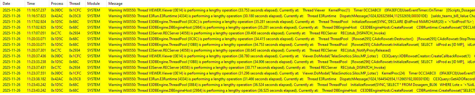

exemplo de uma linha no log que deu erro em um simples select.
16218 2025-11-26 11:23:43.242 0x1D5C 0x68C SYSTEM Warning W00550: Thread E3DBEngine.DBEngineHost {2984} is performing a lengthy operation (36.525 seconds elapsed). Currently at:
Thread DBEngineHost
CE3DBEngineHost::CreateRowset
CDBRuntime::CreateRowset(“SELECT * FROM Dosagem_BL06
WHERE Lote = ‘<%idLote1%>’ and idBat = ‘<%idBat1%>’ and Cod_MP = ‘<%idMP1%>’”,0,1)
CThreadRowset::StartThread 11
