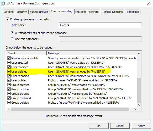

  2. How to log deletion of any user activity in to audit trail.

Regarding to your questions:
  1. No, the ‘EnableCommError’ property cannot be changed in runtime.
  2. Just enable system events recording and the specific event in the domain settings, as you can see in the image below.

I am using E3 Ver 2.5 in which the following options are not available in domain during Run time.
