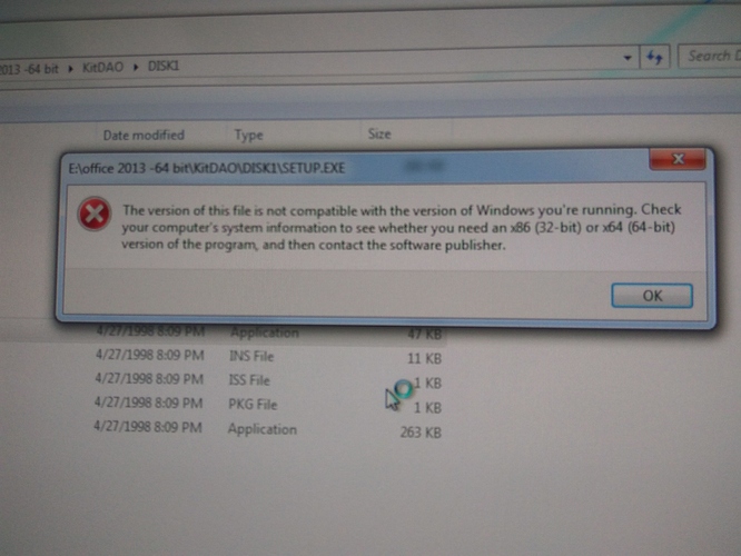

Help required to Install Elipse SCADA kitDAO in Windows 7 (64 Bit)
We are upgrading our Computer as our present computer having Windows XP (32 Bit) is running very slow. We have planned to replace with HP Workstation(Z440) having Windows 7 OS(64 Bit).
I did install Elipse scada in it but not able to install KitDAO.
Your help is required to sort this out
Thanks & regards,
Amol Raut
India
@Amol_Raut,
KitDAO is not compatible with 64-bit systems. In this case you have to create a 32-bit ODBC connection.
Related articles:
http://kb.elipse.com.br/en-us/questions/5025
http://kb.elipse.com.br/en-us/questions/4560
