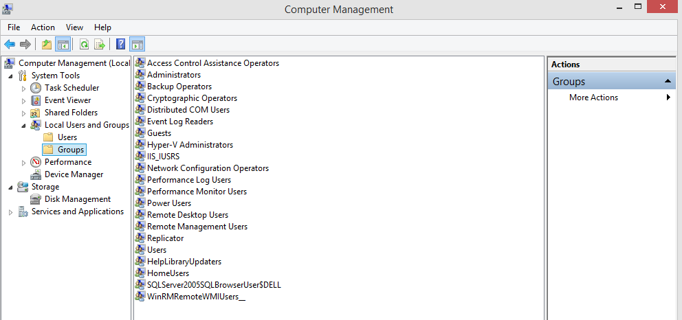

Can we use windows local group in our E3 group.?? In this case IT person will configure users and give rights as per this groups.

Dear Mayank,
The mentioned sample application is intended to provide a simple demonstration of how to access AD users and groups by script. Message boxes are for didactic purposes only. There is nothing ready to use this way, you need to develop all the desired integration from this initial base.
