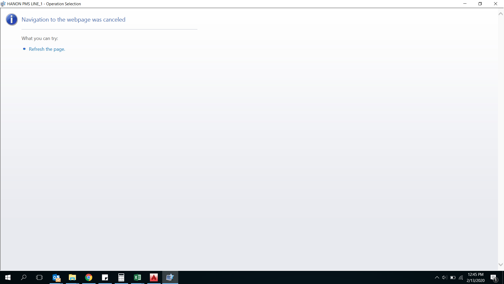

Viewer Page Load Error
Dear All,
Viewer Error - “Navigation to the webpage was cancelled”
Error Occurs in Only one specified Screen and In Main server pc that screen is working.
in another pc viewers working correctly
pc spec:
Windows 10 ,64bit
Hello @selva,
In this machine, execute the file !register.bat in administrator mode.
You can access this file in the path below.
C:\Program Files\Elipse Software\Elipse E3\Bin
or
C:\Program Files (x86)\Elipse Software\Elipse E3\Bin
Try it and tell me.
